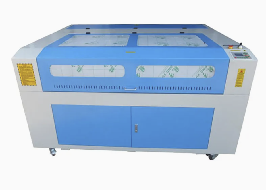

I have purchased a new CO2 130 watt laser
https://gsmachine.en.made-in-china.com/product/tdInOyATYLWf/China-1390-Laser-Cutting-Engraving-Engraved-Wooden-CO2-Laser-80W-100W-130W.html

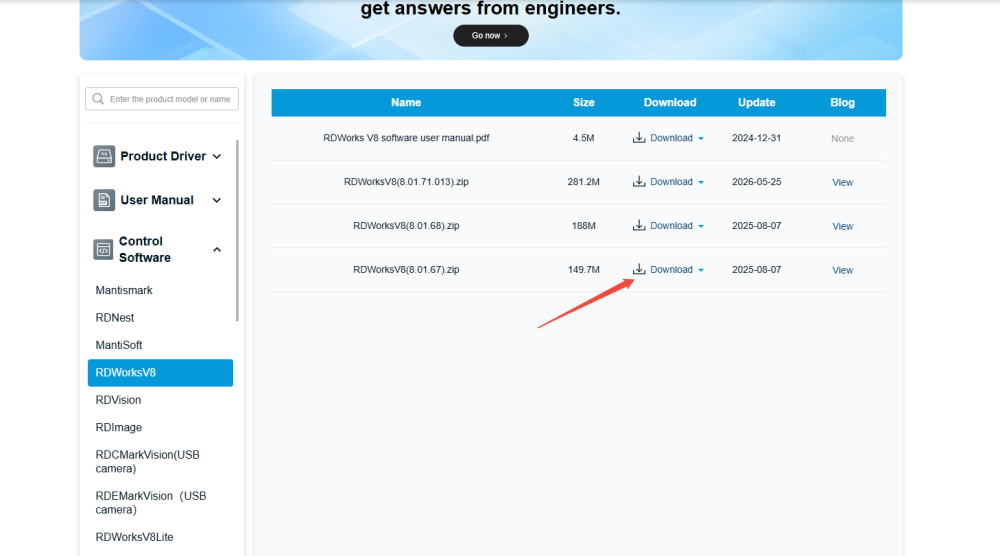

I am trying to connect this to my Windows Laptop however, i cannot find setup.exe when i download USB driver from channelink https://www.rdacs.com/en/download

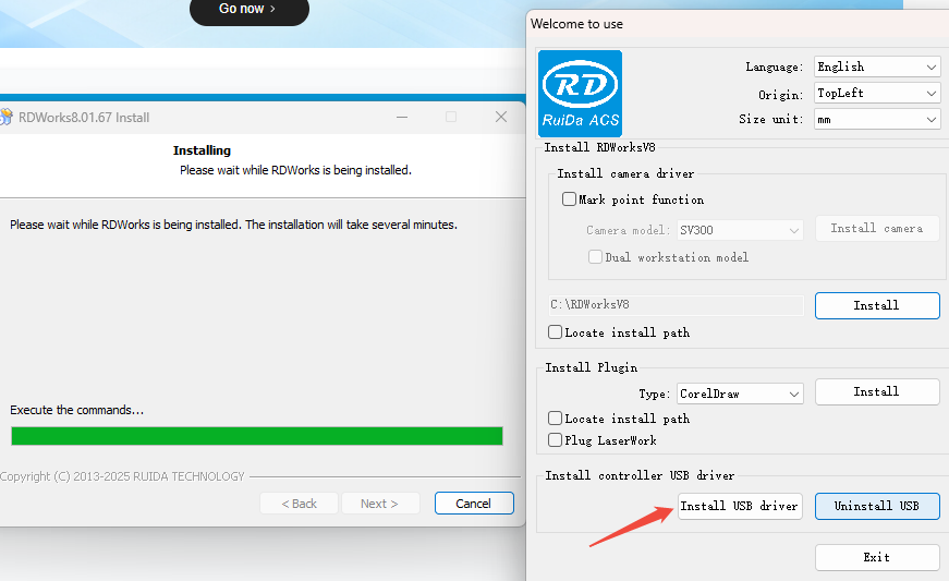

  • Hello, according to your description, the one you downloaded is a manually added USB driver, which is added in the Device Manager. We offer a more convenient and faster method:
    1. Download the V8 software from the official website.
    2. Install the USB driver during the software installation process.
