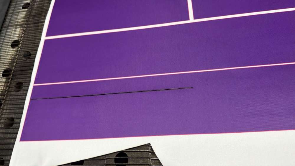

  • I did managed to calibrate the camera sucsessfully.i also put a 0.5mm ofset in the X2 -dir and Y1 4mm and Y2 4mm.and the 2x rectangular cut blocks came together as one pattern. calibration was a breese. But now we are having problems with wrong positioning cut lines. Only sometimes. But my customer is loosing money as they need to reprint and cut again. Anybody know where we can download a new ver of RDVisionWorks 1.00.115.

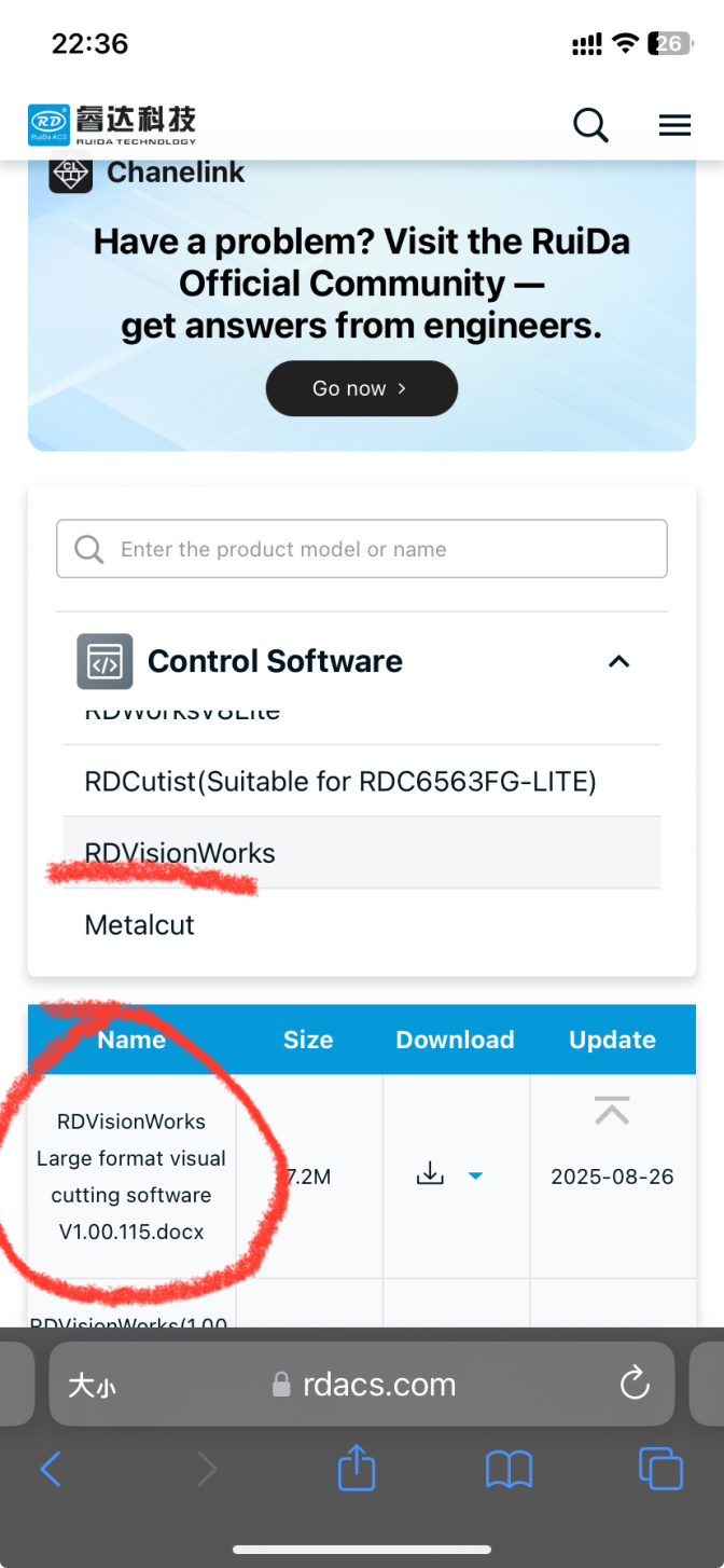

    • Well done,You can download it from the download center of RuiDa's official website. https://www.rdacs.com/en/download?type=software

  • Take a picture or a video to observe the phenomenon  or reference https://www.rdacs.com/en/video/instructional

  • This situation is most likely caused by your excessive speed, which led to the motor losing steps. It requires resetting. Suggestion 1: Reduce the processing speed. Suggestion 2: Reconfigure the user parameters.
